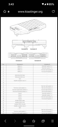

if you're looking for clean switch 12 volt could use the the amplifier for the stereo on the right side of the trunk. keep it all in the back that way there's a rubber grommet by the battery where you can drop through to underneath and just tuck your wire under the heat shielding

so in the trunk on the right I see a small fuse panel with a couple plugs, but no amp.
Would the fuse box be a solution? Like I could get a plug for a fuse socket or something?
btw, mine is a gt1, so I don't have the upgraded sound system if that matters

Well the small fuze panel would be your #1 prefured option You would need to test a circuit that would work under auxiliary or ignition on only , You might have the amplifier and just not see it not sure there

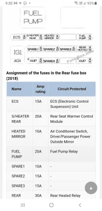

Yes the seat base will lift up. Give a good pull from the bottom and it should unclip. The attached fuse diagram may help......fuel pump would be switched power.

yeah so I checked out that box last night more, and see there's some spares. The friggin prongs on the fuses are so long I can't get the probes of a meter in there to check what is switched. I get the fuel pump is, but I'd much rather use a spare or something far less critical than the fuel pump.
If nobody knows I suppose I can just use a spare and then find out if it's switched.
That box is odd too because there's a bare metal prong in that box that is hot 100% of the time.

What does your meter's prongs look like? Mine are pretty short and can still test...
Just install an add-a-circuit with a fuse that is ignition switched on.
edit: mine is using the ACC fuse
I think maybe mine are just too thick, I couldn't get them in those slots far enough
anyhow, I ordered an add a circuit thing just like in your pic, so once I have that I can just use the pigtail coming off it to determine
what is switched and always on.
