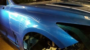

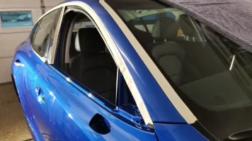

Hi
I just wanted to post some photos of a Full PPF and Ceramic coating of my Stinger. The Detailer took off the door handles and mirrors to wrap the doors.

So, "full PPF" means the entire car being covered? And then ceramic over the PPF?
