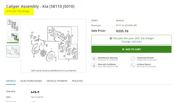

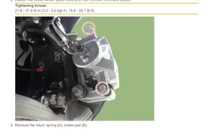

I am pretty sure they are SINGLE piston - Not dual.
Perhaps....they also changed the brakes on the base models, I believe in 2020....? So perhaps thats why conflicting info, or maybe I'm just wrong, lol, could be.
SINGLE PISTON CALIPERS
I think it's the same single piston for all years.
GT-Line’s are single piston. I do believe the rotor diameter has changed over the years for the base model, but to my knowledge the base model is single piston front/rear.
