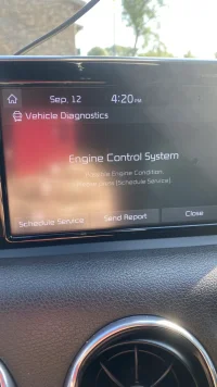

I’m bringing back this post with an unfortunate update. Even after all the drama last week and finally getting my Stinger seemingly repaired with a new coil pack, plugs, and a carbon cleaning (fuel injectors)- I just returned from home on the same stretch of highway that I was on last week when I got the CEL and went into limp mode. History repeats itself because, despite the $1100 worth of maintenance that I had done on Friday, I just got another CEL and went into limp mode.
This time I got an error from UVO. Engine Control System. I suspect this is a direct result of my using Sport mode intermittently. Same as before, I turn the car off, let it rest- the engine now turns normal and the vibrating is gone. But this time the CEL doesn’t go away. I called the mechanic and with meet with him on Friday. I’m very suspicious of Kia over this, especially after considering the few reprehensible service recalls that they have had. We’ll see what happens on Friday.

^^they will find 'it'. these cars are ridiculously complex and everything is found via scanner tools, etc. nobody can just listen or drive it and then be pointed to the problem. all the electronics and computer modules of which the stinger has no less than 33 make troubleshooting and diagnostics a looming nightmare. of course I just hope that your issues, obviously more than just plugs and coil packs, are sorted quickly. it is for this very reason that I have kept my powertrain bone stock.

So, I instead stopped at the garage before going to work. It turns out that my camshaft sensors are not the problem, rather, a cylinder 5 misfire. I ordered a new coil pack to install on Friday. We’ll see how this goes. I definitely encourage the narrative that I have been observing here that when replacing the plugs on these cars, its advised to replace all of the coils as well. That makes two bad coils now. Only 52k on the car.

Ok- now I have a 2nd brand new coil installed on cylinder 5. I’ll be testing this out in the morning when I’ll be on the expressway. Hopefully, I won’t experience anymore misfires. If I do- I’ll be buying four new coils so they will all be replaced. If I get a misfire after that…I’m gonna flip! Fingers crossed!

Lol- I’m glad everything turned out okay for you. Same here. Turned out that, in addition to the other work I had done, replacing the cylinder 5 ignition coil was the answer. All new plugs, and two coils. Problem solved. :thumbup:
