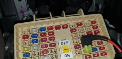

That's why I'm trying to find out more from everyone here i guess because I should be able to assume that the dealer here followed instructions, but if the overwhelming majority is different then that is something to go on.
Take a picture and show us where yours is tapped into.
Cars still at the dealer, they tell me this morning they now think its the powered tailgate module waking up at random. I dont have a lot of confidence at this point. Also annoyed because i bought the car to drive it not have it sit in a bloody workshop.

Picked up today, was told it was a corroded connection somewhere on the tailgate module that was causing it to wake up intermittently and drain the battery. Fingers crossed thats it.
