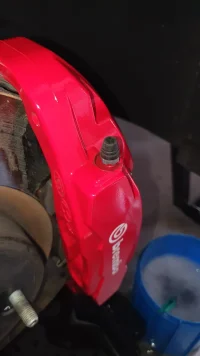

My pads failed but I can't really blame the pads since they died on the track while being tortured.
