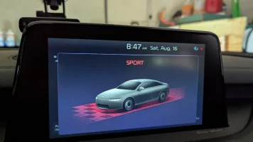

Thank you very much. And my car that switch was inadvertently turned off. Have no idea how that happened. I don't shuffle through that menu very often. However, now the pictogram is entirely different from what I had before. I have attached a picture. As you can see, it's a picture of the car with the label of what mode it's in. Not the exploded diagram that I had before. Don't know how to get back to the other one. There is no other switch or control and the other positions of the switch don't accomplish this.

Ha hah. This just shows how ignorance works. Even my 2018 GT1 has the option to simplify or turn OFF the selected drive mode display. Nearly seven and a half years in, and I only discovered this just now after reading @AdamNZ 's post above. I have selected the simple version now and may turn it off altogether, since the LCD screen between the gauges is enough information on which drive mode you are in, or changing to. I don't like redundancy much.
By the way, the car icon used to be very Stinger-like, but subsequent navigation screen updates turned it into this ugly generic thing.
My 2018 is exactly a Stinger, that generic car graphic is just weird.

I actually haven't updated my UVO, but I suppose when my head unit was factory replaced 2 yrs ago it was updated. All of a sudden my car had sounds of nature as a media mode choice. My Android Auto still works only when it is in the mood despite my having a Pixel phone and the USB Port still refuses to recognize music on it. These have been problems since day 1. The head unit doesn't update itself over the air, so I wonder where that generic pictogram came from.
I've never used UVO. The degraded car icon is the result of KIA navigation/media updates. I think mine lost the Stinger icon the first time I upgraded in late 2018. It might have been a year or two later though. Memory does not serve well here.
I'm sure like many others once the car image changed to what it is now, I changed my setting to simple view.
