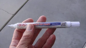

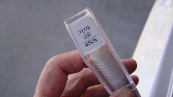

Does your touchup kit have this kind of tip?
Nowhere does it say "Silky Silver" on it. Just a color in the end of the cap. (I've never used the clear coat.)
I also have this "Korean" one. It seems to be an aftermarket product. No mention of Kia anywhere on it. But the storage container does have the paint code. I've used the "pen" tip maybe once. The little brush is handy.
I have no idea if alcohol "melts" these. But I can tell you that, even after days of "curing", if you try to wet sand the touched up spot, it will turn dark; and it never seems to get really hard; you can push your nail into it. So, it's probably the same "stuff" that your Federation Orange is. Bleh. :(

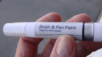

View attachment 50240View attachment 50241
