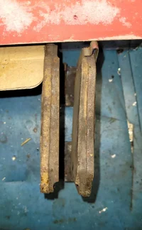

These are my OEM's. Removed at 60k kms.
Shown in pairs, no idea which was left or right, but outers are the ones with the squealer tabs
There is a slight taper, where the leading edge seemed to wear more than the trailing edge. But inner and out pads are even - to my eye. I did not measure with a caliper.
Box of OEM pads - with 60k kms

Thanks for the pics, your rears definitely wore more evenly than mine did. I'll have to pull my pads again in a few thousand kms to check them again.
