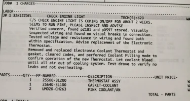

I just had the dealer replace the electronic thermostat (also referenced as the electronic coolant thermostat in the paperwork) in my 2022 GT2. My check engine light went on/off for a couple of weeks before I could get it in to the shop. I had a buddy with an OB reader check the codes so I knew it wasn't anything super serious. The only drivability difference was what OP referenced below; the car seemed to upshift ASAP regardless of drive mode. Like a super aggressive ECO mode. Something interesting was that I was driving in Sport when the check engine light turned on, and it totally disengaged Sport mode. It still showed that I was in Sport (and I think the valved exhaust stayed open) but everything reverted to normal.

The engine light codes came back as P2181 and P0597. The dealership covered it under warranty (I don't have any mods) and it was a harmless process. They had to overnight the part, and said it would take a couple hours to do. I attached a picture of the service details.
