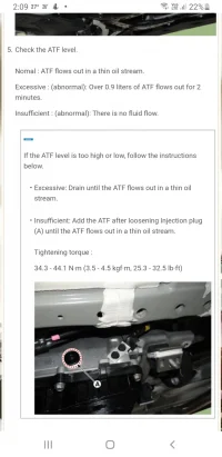

Ah, that's pretty tricky; "raise" the vehicle but keep in on "a level ground"?? That means no half-assed garage ramps. Being "raised" and unlevel would mess with the way the ATF comes out the "inspection" hole.

ATF expands significantly when hot, which is why the level should be checked when hot. Wear gloves. I keep a pair of hot-oil-gloves in my stack of messy-oil-catch-containers.

Likely, your trans had the correct amount of oil. If you just pulled the plug and did not do the fill and check procedure, your trans fluid is likely low now.
As shown above, the trans needs to be at temp, engine running, and moved the shifter through the gears. Only then (with the engine running but in park, raised up on level ground), do you remove the fluid level plug.
Oil will drain from other areas of the trans, mainly the torque converter, when the car is off. When you turn the car on, the trans fluid pump pulls from the pan and fills the torque converter, lines, pistons, etc.
