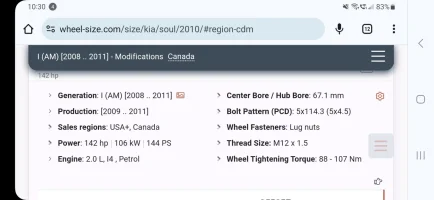

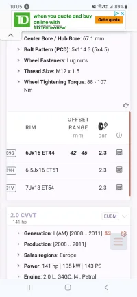

Actual I made a mistake. They are off a Kia Soul. The offset from what I read for a souls is 42-46. Everything else is identical, centre bore etc

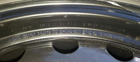

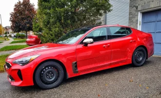

I have used 42 offset steel wheels on my stinger in the past, with 225/45/18 - cleared calipers
Here are the specs for the Kia Soul rims.
18" should clear?

DJ above uses 42 offset steelies, if they are 42-46 they should be good to go.

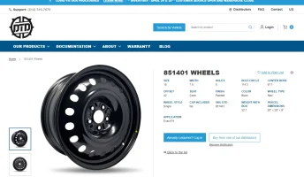

Found another picture.
Can see the rims I used has a sort of bubble shape, to accommodate the caliper. 20220217_085152_resize_85.webp
