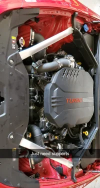

I like the look of mine. I attached a picture of what mine look like before the supports I put in. Still no heat shield though.
That looks really clean. I had chrome piping which didn't look as good as that. And some universal heat shields. I think that's what made it look worse for me.
yeah i thought about getting chrome piping but autozone had these black textured pipes so it worked out really well. And from what i've read, heat shields really aren't that important on the stinger if the intakes are towards the front and right behind the bumper inlets. I just don't have the funds for a real CAI or else i would've got an actually one
