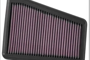

and do you think since i just want the turbo sound can i go with panel intake air filter or it wont do any difference? (see the attached pic)

A drop-in filter in the stock airbox isn't going to change much. The added sound comes from opening up the pathway to the compressor, so any of the intakes that replace the stock airbox (or leave the top open) with a cone filter will probably be similarly aggressive.
I have the K and N drop ins...0 difference in the sound from stock. Minimal power gain if any.
I bought them because they are reusable and filter better than stock.
You can remove/unclip the front off your airbox.
It most definitely makes a louder induction noise (if you have K&N panel filters) than leaving it on, and if you pop your bonnet you will be pleasently suprised how little heat actually is in front of this area.
Although you don't have to believe me, just go try it for yourself... it costs nothing.
Little to no increase in power with no tune, you’ll get more sound from cone style air filters not the drop-ins
