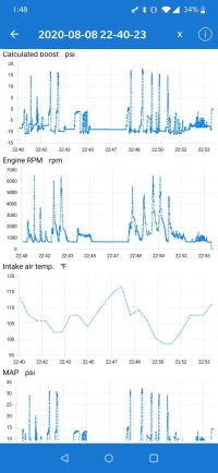

Oh cut boost during a pull? That's not funUmm I went from 20psi down to 6psi at WOT lol. I don't pay attention to boost at idle. Maybe you misunderstood what I was getting at. Its likely not a JB4 issue but I thought Terry may have encountered this on a customer car. I am running a meth kit and the EWG wire mods so there are many variables on the electronic side for things to go wrong. About to go dig into here shortly.
How do you tam the waste gate?Got it figured out fellas. Must have been some limp mode action lol. Reset the ECU and tamed the waste gate settings and she's running tip top again.
Bad gas got me and it sucks! I keep a brand new set of plugs on hand just for any issues but can't do much about bad gas but let it run out.....A misfire will make your JB4 really act up. In my case it was bad gas but it could also be plugs.
