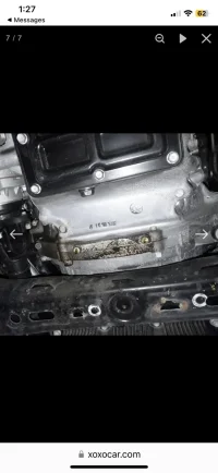

Oh Oh, last oil change mechanic found this. Do you all think main seal leaking

Rear main seal. Hopefully you are still under warranty.

Nope next oil change sometime in January February will get her looked at again. The first dealer screwed me change the oil spray clean the bottom of the vehicle so they didn’t see anything so I’m back to square one. Yes, I even had a picture!
Update stinger is in another dealership right now. Turns out it’s not a rear main seal. Something inside the transmission has failed and is leaking out. Techs are currently saying full transmission replacement. What a bitch between a botched oil line recall two weeks without the car a few months later now this? I love the car but I’m really disappointed in Kia quality.

Just got an official reply from Kia boy I sure thought this was a rear main seal. Sure looked like oil on the bell housing. Kia has said the torque converter shaft. Seal is leaking accumulating in the bell housing. The factory has approved. New replacement still two weeks out.
