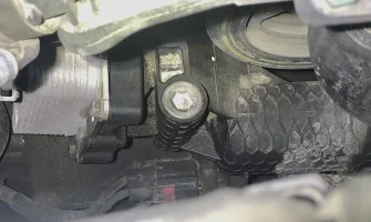

I figured if you pull the oil housing off the block can you then get to all the bolts you need on the cooler and NOT have to break the waterlines, then replace the 2 oil seals?
just get yourself 2 hose clamps, and it will stop the flow of the coolant, and all you will lose is the little bit that's in the cooler.

the amount is so small that you don't need to do that. I didn't, and it's been almost 2 years and 25,000 miles later, and I don't have any issues
