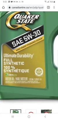

I use Quaker State Advanced Durability 5w30 Synthetic. I had mine changed at 1000km, 5000km then 10000km. Moving forward I will be doing it every 10000km. I also have an oil catch can installed. The Quaker bottles specifically say designed for Turbo vehicles.
I hope you mean ultimately durability. The QS ultimate actually looks a little more stout than PP.
Ultimate Durability it is
