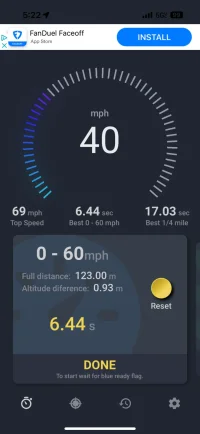

Hey all, I am new to the stinger world and purchased a 19 GT2 2 weeks ago. One thing I’ve noticed is complete lack of power, I went and test drove a few others and this car is not fast??? I thought maybe it was fuel, cheaper dealership. I’ve now gone through a few fill ups with 93, still no change. Sport mode is certainly more responsive but I did a 0-60 pull early this morning 55degress low humidity, and I got 6.44. I did a video a week ago, counted it out from launch to 60, roughly the same. The car does have injen intakes and an oil catch, installed by previous owner. Not sure if it has more. But this does not compare, launch mode….feels slower than my 21 2.0t wrangler on 35s. Anything I should check? Boost on the factory gauge it’s maybe 8-10psi, but I know this car has more in it. I can’t even get a slight break in traction??? Help me

I double checked and did a launched this morning. The screen says launch control ready then I let off the brake. It says active again 0 to 60 time 6.3 seconds which could be off slightly but I wouldn’t think one and a half seconds or more. I have no check engine lights. Everyone tells me the boost that I’m seeing is correct for factory at 8 to 10 psi me. It’s almost like there’s a boost leak. If I get the chance today, I should go through the intake and make sure everything’s buttoned on and tight.

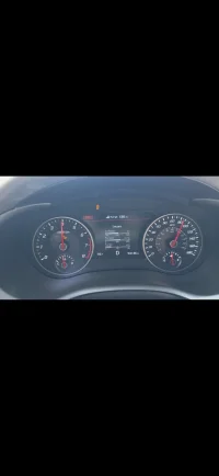

This is Max boost I’m seeing, that’s normal?
Take it back to the dealership you got it from. Stock turbos should be somewhere around 14psi stock. Based on that picture you’re getting less than 10psi total. Your 0-60 should be ~4.6 seconds, max, with those conditions and 93 octane, especially with Injen intakes.

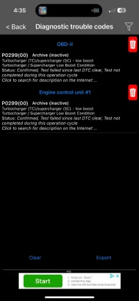

Pulled codes, found this
Google search:
The P0299 code indicates an issue with your vehicle's turbocharger or supercharger, specifically an underboost condition. The code is triggered when the ECU detects that the boost pressure is too low, which can be caused by a number of components and conditions:
  • Air restriction or leak in the intake
  • Binding turbocharger
  • Faulty pressure sensor
  • Sticking VGT vanes
  • Variable geometry turbocharger actuator
  • Fault EGR system
  • Restricted air filter
  • Blocked catalytic converter
  • Exhaust leaks
