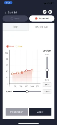

Nice, I’m going to try those out. For 5 months I’ve been using the ECS10 on my
G70, but only basic mode. Trying out the advanced maps and I’ll give this a shot as one of the custom modes.
Try this out if you’re looking for a sport + handling mode;
- Keep the compression (ride) relatively low and the rebound (handling) significantly higher. The compression should be set low enough to allow some “give” when you hit a bump, but also be stiff enough to provide some resistance for ironing out shocks. The rebound (handling) should be set relatively high because it provides good body control without significantly impacting the ride quality. It’ll prevent that floaty feeling and sort of suck the car to the road
- @ lower speeds: soften the front and stiffen the rear. This setup uses the rear suspension for body control while allowing the front wheels to maintain better contact with the road and provide more grip. It really livens up the steering/front end sharpness.
- @ higher speeds: majority stiffness transfers to the front. Here the front suspension controls the body so that the rear suspension can position the rear wheels for maximum grip. Dynamically this results in better high speed stability.
Whenever I want to maximize fun in the corners, I switch to the custom mode I named “
Dialed”. It feels like everything tightens up. Steering becomes super sharp, and feels amazing. Grip isn’t an issue. I have AWD, limited slip diff and Brembos so the computer always finds a way to sling me out of a corner. Admittedly the setup is on the stiffer side. Not unbearable, but I don’t use this mode unless I’m driving spiritedly. Try it out and let me know what you think. It’s;
Dialed Mode
| Front | Rear |
Ride (Compression) | 29% | 40% |
Handling (Rebound) | 48% | 75% |
