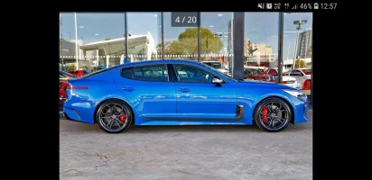

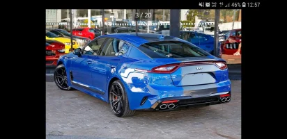

I thought these looked cool
They were on a car for sale, they are 20" Koya
Not sure of offset though.
