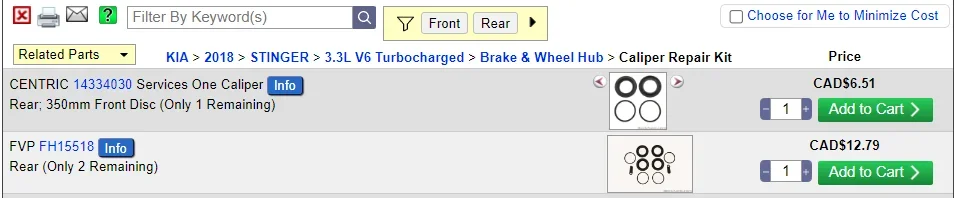

Replacement calipers are easily available from Ebay, but pistons and seals are available to rebuild yours.
Yep.... Caliper seized up and was hoping to see if anyone was selling.
Is it possible to have it repaired ?
these seal kits do not included pistons.
the pistons can usually be cleaned.... but new ones should be available for purchase somewhere.
I really suspect you can clean up and re-use your existing Brembo pistons.
