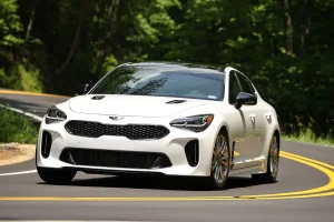

These are 18x7.5 ET39 OEM wheels I kept from my '09 Genesis sedan... in 1 of 318 curves on The Tail of the Dragon. I believe in "what works good looks good", not the other way around. We have 7 sets of 18" wheels between our two Stingers and G70. I could've taken any of them on our Summer vacation to the Smoky Mountains. The more performance-oriented ones would no doubt have worked even better in the slice and dice. Still, I decided on this set because, shod with 235/45R18 all seasons, they are supremely comfortable on the 1000+ mile drives to and from. Everything has a purpose of what it does best. It's up to you to decide whether that aligns with your expectations for your particular use case.

That said, this 18x7.5 ET39 you have the link for... won't work on the Stinger. Wheel size and offset are fine, but the wheel hub diameter of 66.1mm won't fit Stinger's 67.1mm wheel hub.
