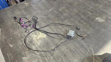

Greetings, First post here...My wife drives the 2020 Stinger AWD Turbo...and I rarely even get to drive it LOL but today after an oil change I discovered a little...gizmo for lack or a better word, I have no Idea what it is. It's next to the fuse box and OBD2 connection. If anyone can enlighten me on what this is, it's greatly appreciated...BTW...one owner, original owner (us) and never been to the dealer for anything
Photo attached. THANKS in advance!!

Some kind of tracker? Looks to be plugging into the obd port.
Ya know, I was thinking...we got the Stinger in 2020 as a lease, loved it and bought it out. I wonder if it isn't a remote kill switch. One way or another it's going, going GONE if it 's not KIA OEM.
A reverse image search confirms this same button on other leased cars, sometimes called "Karr Alarm", installed on leased or financed cars at the behest of the financing company. I think you'll need to trace it to the module and check the part number to see whether it's a tracker or immobilizer, as well as how many other wires they tapped into.
Seems common to just slap them onto interior panels with self-tapping screws (instead of spending 2 minutes to tuck them away, or at least use double sided tape or velcro). You could probably make the holes mostly disappear with a bit of black rtv/silicone, but for future purchases/leases I'd be on the lookout and tell the dealer I didn't want any crap drilled into my car (or ask for a replacement stock panel if already installed).
Thomby!! You're my HERO. It was in fact a KARR ALARM. I just removed it and all is well, but let me just say, it was a huge MoFo to remove. FORTUNATLY...I have a shop with a hoist because crawling under the dash of a Stinger is NO FUN.

I guess they figure most people never pay out a lease so the finance company always owns the car and wants to be able to track it or immobilise it if the lease payments stop.
That's good to hear. Looks like a handful of spade connectors and at least one pair of severed wires. I assume you reconnected/terminated everything they tapped into on the car side?
I don't know that this system would be the obvious culprit behind limp mode or cylinder misfires. Normally limp mode is from something like overboost (not sure your location, but more likely in winter cold with denser air), and cylinder misfires could be a number of things...but maybe the immobilizer cuts spark or something.
I guess you can clear the codes, give it some healthy exercise, and see if they return.
