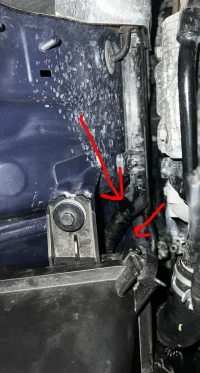

Snap a few pics next time you look at it, if it's not raining.
This is usually where the coolant sits at and some under the intake box
And I’m pretty sure this is supposed to be straight I’m guessing the coolant reservoir was bone dry while sitting on the car lot for so long
look above that on the engine, that's where the throttle body is. There are coolant lines running to it. That'll be under warranty. just take it to a dealer.
