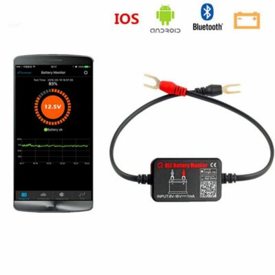

I ended up buying the Century monitor. In the first 24 hours it identified the culprit for me easily. My bluetooth OBD2 dongle (that I use with Torque Pro and Racing Meter) will constantly try to establish a connection with my phone if the app is still open on the phone. The interesting thing is that the definition of open is different to what I thought it would be. I swipe up to close apps on my Android phone - but that does not completely close them and they still try to talk to the OBD2 dongle. To close it fully, I have to use the exit option from within the app (a new learning for me!).
With the Century battery monitor installed - I was able to see all this happen in real time. There was no doubt whatsoever as to what the culprit was.
So - having the car key close to the car MIGHT increase battery drain a little, but having the Torque Pro app not fully closed while you spend 3 hours detailing the car (not to mention sleeping in a room directly above the car ... with the app still trying to talk to the OBD2 dongle all night I presume) is the real cause.
If anyone wants a VERY DETAILED analysis of the different battery monitors on the market - pros / cons etc - reach out to me. My brother wants to get one for his car / caravan - so I analysed them all (and the associated monitoring apps) earlier today.
