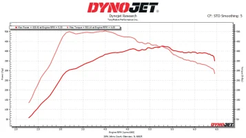

I drive a 2019 GT making 425whp and 503wtq with these mods - dyno tune for 93 octane, JB4 tune for WMI, intake, exhaust, intercooler, WMI, downpipes and plugs. Looking to make more power and not sure what the next best mod would be? Any suggestions? Thx! 2019 Kia Stinger GT AWD Dyno Sheet After Tony Motive Mods December 2023.webp
Do you have secondary downpipes or both the primary & secondary downpipes installed?
just secondary.

Got it, the reason I asked is because secondary downpipe’s net approximately 12-14hp if that.
The Ultimate Performance HFC Downpipe + Mid Pipe Combo Kit makes 46whp & 62wtq on a stock Stinger 3.3T.
We always encourage customers to avoid going with just the secondary and instead going with the primary and secondary downpipe together to gain the most Performance out of their Stinger. I’d recommend swapping the secondaries out for the combo kit to make an additional 30+hp.

That's a good amount of power you putting down. You can do a BEF+ from KJT. His e30 tune is aprox 475 whp/556 tq. That's probably what I might end up doing. He did the headstuds for the bms project single turbo stinger that they are building which I am dying to see in person as i live pretty close to the shop.
I run jb4 map 3 with e30 and it's amazing, tons of power especially being awd. I have the fuel it sensor hooked up to jb4 and it's super nice. It makes it super easy to full up and see ethanol content and it communicates with jb4. I probably wouldn't run e30 guessing always without that fuel it sensor. I usually am around e28-e30 always.
Stock primaries with catless secondaries, catback, bms fmic (going to get the bms chargepipes too), k&n intakes. It probably will run better with his tune and bms tcu. That's all I'll end up doing likely to my car. But yeah that will give you a nice bump in power.
