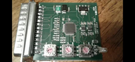

Hello everyone,
I recently picked up a CPO 2021 Stinger GT2 with roughly 30k miles that was reportedly a lease.The Carfax is clean and shows a history of regularly recommended maintenance.
Admittedly, I’m not engine savvy (hoping to change this with my Stinger) and I’ve noticed my car came with what appears to be aftermarket k&n intakes and what I’m assuming is some sort of performance device. The device has a green light that blinks intermittently while the car is on. The car appears to be in great condition and haven’t had any issues so far. However, I’m concerned that these mods could be an issue if I ever need warranty work.
Does this device look familiar to anyone? This vehicle has become the coolest car I’ve ever owned and I’d love to learn as much as I can to keep my Stinger running as long and efficiently as possible.

That small box is a lap3 chip. Try to disconnect it and see if you can feel the difference. But that chip definitely can void the warranty.
You’re awesome my dude. Thank you, do these typically need to be programmed? I have a few days off coming up. I’ll spend some time testing it.
It's plug and play chip, already programmed. You shoud feel decreased power when you disconnect it. And don't put anything lower than 93 octane with that chip.
Right on, thank you. I know it’s difficult to say, but assuming this is a 1.5 chip, how much hp do you think is being produced?
I dont know that. 50-60hp maybe. But it should be noticable.
jeeez, that’s a lot of power. Although I don’t have much experience, I don’t think I’m seeing that much of a power boost, but, I imagine I’ll be able to tell once I disconnect the chip.

When increasing the boost it's very recommended to replace spark plugs with smaller gap. But I am guessing, the previous owner did that already. Pull one spark plug and check. If it's hks brand, that will be great.
Thats a Typhoon duel Intake system with K&N cone filters (i don't think they make the typhoon kit anymore). Those filters need to be cleaned and oiled periodically (there is a kit you can buy at most auto parts stores that includes a cleaning solution and a filter oil, I suggest O’Reilly Auto Parts)
Yea, like already stated, thats a LAP3 piggy-back tuner. I had one on my K5 before I upgraded to the JB4.
Blinking green is good. If its blinking red only, its connected incorrectly.
It operates independently of the ECM, but yes, if you have a warranty it will void it. You want to remove it before the car goes in for service (thats the bonus of the piggy-back design).
Based on its appearance, that chip is one of the earlier models (again, looks like the same one i had before). It actually has 3 performance settings. To change them, you have to unplug the serial connector and remove to 2 allen head screws to the case, then it slides open. Inside you will see the circuit board and 3 dial resistors. Use a small flat screwdriver to turn the dials.
Below is my chart for the 3 different HP settings (turn the dials like a combo lock) and the required octane fuel for each one. The more HP it adds, the higher octane fuel you need to use. The 3 settings are ROUGHLY +20hp, +40hp and +60hp.
Yes you should pre-check the spark plugs that are in it. If they’re not HKS, you should replace them with HKS if you plan to run the tuner regularly.

You’re awesome, this is extremely helpful. By chance, would you be able to explain how to safely disconnect the chip? I’ve checked YouTube (maybe I’m not looking hard enough) but I can’t seem to find a straight forward video of how to disconnect the chip.
Just make sure the car is fully turned off and “asleep” (dont take the transponder key near the car or it will “wake up”). Its best to disconnect the battery anytime you fiddle with electronics of any kind.
The tuner has a wiring harness with 2 primary ends, and on each end are 2 connectors; a male and a female. One runs to the MAP (Manifold Absolute Pressure) sensor mounted on the passenger side of the intake manifold, on the top/back side between the throttle body and the engine, and the Boost Pressure sensor mounted passenger side on the charge pipe between the throttle body and the intercooler.
Basically, all you do is disconnect the tuner from both of the sensors, and from both of the factory connectors, then re-connect the factory connectors directly to the sensors; just like stock would be.
Then just remove the tuner and its wiring harness. The car will act like stock.
I suggest you label which connectors go to what sensor before you remove the tuner. The connectors are VERY similar and it’s possible to mix them up when you re-install it.

Correct, it would leave things disconnected… and its doubtful the car would even start.
Its really pretty simple, just follow the wires from the tuner box to the sensors.

Had to disconnect it today and I can feel and hear the difference. I'm n the fence if I'm going to reconnect it when it comes back from getting serviced. Are there any significant cons other than warranty concerns?
