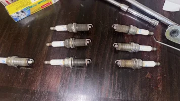

Just changed out the factory plugs. All cylinders seem to be performing the same. The plugs are arranged as you would be looking at the engine from the front of the car. The extra plug on the left is the one I changed last week for cylinder number one that was cracked. It was just to get me by until my Denso’s arrived. I did the “hard” side first and wasn’t as bad as some make it out to be. And I left the intake on. 30-45 min process, not counting the dinner break. I do want to ask if maybe someone can tell me why the plug boots and plugs for cylinders 1, 3, & 5 on the pass side were dirty AF but the drivers side plug boots and plugs were clean as could be? Strange to me. No oil leaks either, just seemed like an excessive amount of dirt on them.
