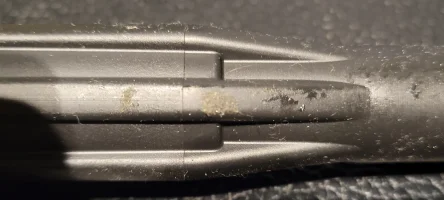

You are correct about the fuel pump noise. The coil packs however are funny and most of the time will
not trigger a CEL and will cause audio dropouts in the entertainment system. There are telltale signs on
the coil pack boot that will show that voltage is leaking. I have some experience with this and it was
a real issue with the oem coil packs pre 2022. If you let them go they will foul the plug and give a CEL.
Having said that, those two marks that are yellowish are a sign that the boot is leaking voltage and this
can be intermittent thus causing the audio drop outs. Just my experience on the matter. They make
far better boots now for the coil packs now so maybe check that out. I would also get a code reader
that is a little better than the ones at the auto part stores. If it were me and you have the tools, pull out
your coil packs and give them a look or just replace all of them with newer OEM or aftermarket coil packs
before you foul another plug.

Thanks for the reply. It’s timely because while the car is driving well and the light is still off, I am still getting some intermittent audio dropouts. Maybe not as much, not sure. I
will inspect the original coil pack that I removed for any yellowing but I suspect the primary offender is still in the engine. Expensive but I may just buy 5 more of the new packs and be done with it.

Happy to help. Agreed, I am sure that there is another one leaking. You will get it sorted out.
