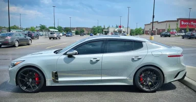

So there are a few people on the Stinger Facebook group that run 255/35/20 and 295/30/20 and lowered without rubbing issues, so I assume it will work. My setup works perfectly without any rubbing or anything negative and I’ve driven 10,000km+ on them so far over subpar Canadian roads and it’s held up great!
