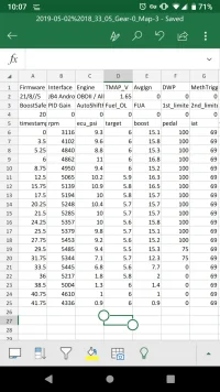

No shortage of JB4 customer logs posted around, the N54tech thread probably has thousands of them. :)
I've seen 12-14 PSI stock (cold temps 12, 14 hot) when measured with gauge. My reading on my stock dyno run was just a hair under 14.
I've seen bumps up to that range without JB4, but not consistent. Typical little roll-on log:
