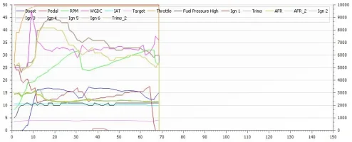

Just installed the EWG connections just wondering if everything looks good. Had 91 pump gas in this log.
Car feels strong just has a slight lag when putting my foot down initially. Don’t really know what each setting does what would make the turbos spool faster?
Seems fine to me. EWG connectors are doing what they can to increase spool speed by spiking WGDC up.
Thanks Terry. Is there a link or different thread that explains what each function does when adjusting the map 6 settings? Car runs great with only an increase of 4psi I want to experiment around with the settings to see how much I can push the engine.

What other mods do you have and what fuel are you using. Thx
Just injen intakes and denso step 1 plugs with e30 mix. Car feels good just wondering if there’s a thread that explains how to adjust each setting on map 6 so I can experiment with it.
I started a thread “Who’s using Map 6”. Hopefully we get some comments from those with more knowledge.
