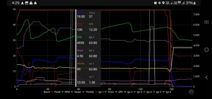

However my ignition timing gets as high a 43, afr is high 14s low 15s. Is there a link for these kinds of questions? I did a skim over the forums and did not find anything.
Ign1 (absolute timing advance) or Ign2-5 (relative timing retard vs. cyl 1)? And is this at WOT or when you let off and are cruising? Both timing advance and AFR can get pretty high off-throttle in a modern GDI engine...I think I've seen 17+ AFR. But when you're doing a WOT pull you should expect more like 12:1.

You really need to post a log (csv) for anyone to guess what's going on.
