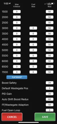

So I found out that some settings where wrong on my jb4 .I don’t think it caused any issues since now it’s running way better. I still have not gaped the plugs down and have some logs on map 1 hope these can tell if my car is good to use on map 2 . Still have been only using 91 octane. That page was all 0’s except the boost safety free changing it to these settings it good.
