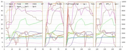

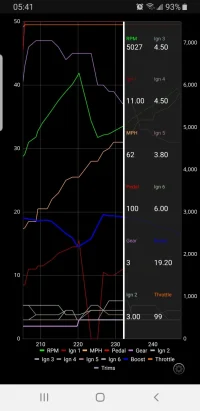

Wow... ok. Thank you.First, dont hit the Logging button, it makes your log huge and mostly unusable. Set you logging up to record at WOT around 80 to 90%. It will help us tremendously sort through it.
Second, my personal opinion is Map3 is too much. Your timing variations are too spread out and not worth it to me. Map3 is tricky. I run 93 with E85 and I skip it. If I want more than 2 I go to Map7 meth. If you had 93 with octane boost or E85 it might look better. IMHO
