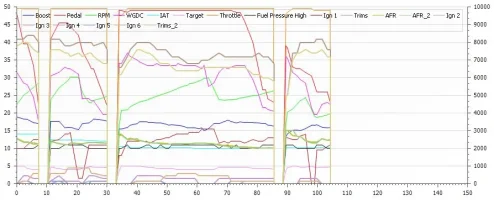

Map 2 check
Did you do any pulls at map 1? I would send this straight to Terry....the fact that Ign's 2-6 are recording a bunch of "zeros', would make me put it back to map 1, better yet, 0 and re-check plugs. Terry can give you the "actual" rundown.....
Temperatures were pretty hot, but I background map one if it’s that warm out. That looks like a 91 fuel correct?
You sure everything is plugged in correctly?
Iat temps are high. Seems ok but I would run a lower map if it’s that hot
Seems normal to me.
