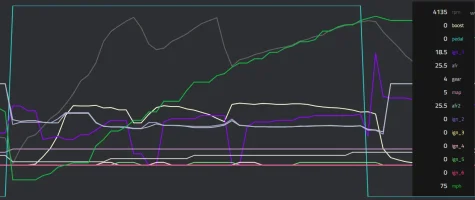

I’m pretty confused In my log it spiked my ign 1 super high once I got off throttle can someone explain, i feel this isn’t good? My corrections on 2-6 look good. They used to be worse. I just reset the battery and took this log after driving for a bit. Any suggestions?
Timing spike are normal, they happen in all cars. There's no boost or compression when the throttle is closed, nothing to worry about.
This log looks fine to me. No issues with MAP 1. Are you limited to 93 octane? By the way give the ECU a day or so to adapt after a reset.
Check out these Datazap excerpts
- Blue across top is pedal/throttle (100% dropping to 0% near the end)
- Green is speed
- Light grey mountains are RPM (shifts should be apparent)
- Purple is ign1. Note the increase with RPM, hard drops at each shift, and spikes to 30-40+ degrees when the throttle closes
Yes, I am limited to 91 unfortunately I was having issues before so glad to see it’s all good! I put some e in so I can do map 3 that’ll be the next log. Can finally rip map 1 atleast.

Could you check this one to?
This is a clean log to learn on, since you have a single WOT through three gears (start with RPM, Gear, and MPH columns to get your bearings). Target boost, fuel pressure (fp_h), and AFR as as expected. Ign1 (overall timing advance) increases with rpm with no corrections (generally 3+ degree drops), and ign2-6 (timing drop relative to cyl1) are all zeroes.
For the last part, it's normal to see 0.8, 1.5, maybe some 2.3s, what you don't want is a bunch of 5.4s etc. All zeroes means you likely have octane to spare, and may support a higher map.
