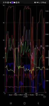

Hey guys, So i installed my jb4 months ago, never really used it. Recently swaped my densos out for hks, got torqued to right spec and installed properly. Currently running intakes, and 93 octane gas from the stations over here. Im really curious for some thoughts on this log, and want to know if you guys think its safe to run map 2 or 3.
Heres the log: The ui on android is abit buggy, im pretty sure i did 2 logs but it only is showing up as one. The big pull was 0-89mph foot slammed on gas. Car was warm for about 30 minutes.
Graph shown here:
If you guys need longer log, i will try to get out tonight on parkway to let it rip hard.
So guys, Just ran to my closest e85 pump, i took another map 1 log prior using just 93 oct, which you will see in here. Then i did an e30ish mixture, ran in map 1 for a bit, then map 3 with e30. It sure as hell felt good, did not notice any misfires. But if someone could check this out that would be awesome
