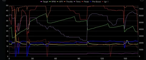

Not sure if i captured the logs correctly but just wanted to see if everything looks fine.
Currently have stock intake and ark mid with mbrp catback.
I assume you have stock plugs? What gas were you running?
As far as the recording you did it right. Nothing in the log stands out in map 1, it looks ok.
Yea stock plugs. Installing densos in a couple of days and just wanted to make sure everything looked fine on map 1 before going to map 2. Thank you!
Seems fine to me!
Yes trims matched and moved proportional to fuel enrichment.
