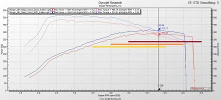

I thought the fastest times were more like 58-5900. If you shift at 5500 you'll drop to ~3500 rpm in 2nd/3rd, 4000 in 4th, 4500 in 5th, so you won't be straddling peak power and maximizing area under the curve. At 6000 you'll be dropping to 4000, 4500, 5000, which I think will capture the most power.

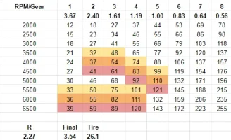

Here's a table I made (verified against rpm/mph in logs and knowing 80mph in 8th is ~2100 rpm). So you rev down the chart then shift over a column to the matching speed to find rpm where the next gear will engage. Red is for shifts at 6500, orange for shifts at 6000, yellow at 5500:
Edit: it did not like my pasted table so had to replace with an image (for anyone trying to replicate, you can get mph values using: RPM / gear ratio / final drive * tire * 3.1415 / 12 / 5280 * 60)

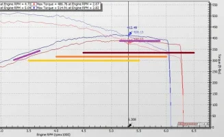

I'm not disputing that revving all the way to the 6500 rpm redline isn't ideal, because torque falls off steeply enough by then that you're making less power than at the revs where the next gear engages.
But if you shift as early as 5200, you're giving up an extra 500 rpm at basically peak power (flat purple line), for time in the 3300-3700 range (increasing purple line). How can that be faster?
