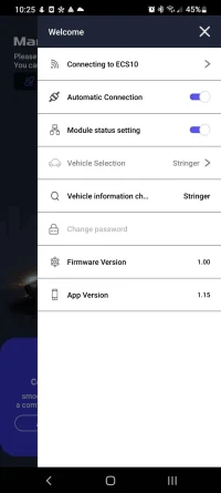

Also, the connectivity for the unit all went through the app, I did NOT add it through the OS like a regular Bluetooth device.

In that screenshot, are you connected to the ECS10?
