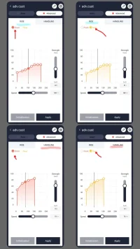

A speed dependent profile like this one works well for me, for spirited driving.
This one is not particularly comfortable if you crave comfort.
It basically ramps up the damping level with speed, for both the ride, and the handling modes.
oh shit that's awesome, I didn't know it had speed-dependent options. are there options for specifically adjusting compression/rebound or further high/low speed compression and rebound?
Low speed compression adjustability only.
The high speed compression valve and rebound valve are fixed rate.
But you can control the damping rate based on vehicle speed.

Yeah, I would certainly appreciate having rebound damping adjustability also..
But I think you will be pleasantly surprised with how much you can accomplish with only variable compression, vehicle speed dependent damping.

There isn't a direct comparison, but if I had to attempt a general comparison, I would estimate stock OEM is in the range of:
Comfort: between 20% to 35%
Sport: between 25% to 40%
(There is a noticeable, but subtle difference between OEM comfort and sport)
The Mando ECS10 comes with 2 included profiles with the same names:
Comfort (ECS10): 15% to 30% softer than OEM
Sport (ECS10): 30% to 45% firmer than OEM
These are LOOSE approximations in my opinion, the electronic dampers, do vary their damping force quickly and often when using either comfort or sport.
With the ECS10, you can make a basic profile that is not speed sensitive.

Once you get the ECS10 installed. Create a basic 100% profile, and go for a drive. It will feel like your dampers are damn near locked up solid, extremely firm!
