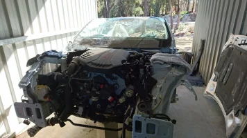

First post, I'm a bit of a Stinger fan and a bit of an old car fan as well. Unfortunately I don't need a new Stinger as a dual cab ute is more practical for me here in Australia.
So I have bought myself a damaged Stinger and I am hoping to use the engine and gearbox in my hotrod build. 3.3l and 8 speed auto seems good to me.
Goodness knows if I will be able to pull it of but I will give it a crack and hopefully learn something along the way.
To date I have stripped down my little Chevy and set the chassis up on a jig. I have just installed the independent front suspension and mocked up the engine placement. It may even fit.
I plan on using a Motec ECU so that I can disable a bunch of stuff that will not be on the hotrod.
I am hoping to use the Kia instrument cluster, steering column and as many items that the wreck I have will allow.
Anyways her are a few pics of the project so far. Hopefully along the way I can get some advice on engine and exhaust modifications.
