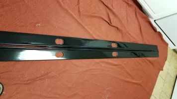

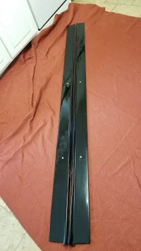

Modding the skirts to fit with OEM mud flaps and puddle lights.
Had to trim about 1 inch, front of the skirts to fit.

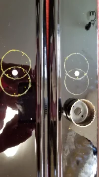

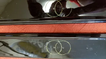

Then marked where the puddle lights would shine through. Drilled pilot holes and cut.
Tomorrow ... will dremel the holes to make ovals, sand, and fill the gaps from cutting with 3M 540 polyurethane sealant, and apply 1 inch 3M VHB tape with adhesive promoter to the skirts.
Then the fun begins! Will stick skirts in place and secure with self-tapping screws and push pins. Roll safety all!
