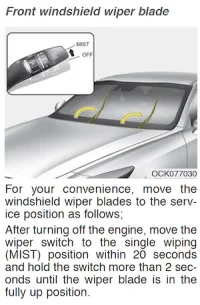

Also, is there a way to actually move the wipers off the front screen in order to wash the windscreen. They get stuck behind the edge of the bonnet. I'd read the manual but it's like War & Peace!

Wipers - I havent messed with the speeds much as Auto is always fine for me, maybe someone can help with that. But for washing the windshield. When the vehicle is turned on just on Accessories (engine not running) hold the wiper selector up for 3 seconds and it will bring the wipers up and stop and then you can pull them up off the windows.

The wipers have a "service" position, as shown in the manual:
I always seem to forget the wiper service position when washing the car and I always have to look it up
