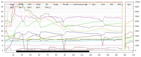

Hello terry would you mind also taking a look at mine, i recently got the waste gate wires and want to make sure everything is ok.Tuning looks fine although the fuel quality is a bit choppy. You'd pickup power with more octane.
What kind of gas are you running? I think you are where I was with timing issues. I had not enough Octane and worn Denso'sHello terry would you mind also taking a look at mine, i recently got the waste gate wires and want to make sure everything is ok.
Interesting thank you, Those runs are on 93 octane, is that not enough for map 3 anymore or should I check my gap? I have the HKS plugs gapped at .022 about 5 months agoWhat kind of gas are you running? I think you are where I was with timing issues. I had worn Denso's Gap was .028!
I was actually faster on Map 2 because I was pulling timing on Map3
oh ok i see, im running 93 octane, i always make sure to get the best possible gas in my area being costco. I have the HKS plugs gapped at .022, last time i did my plugs was 5 months agoWhat kind of gas are you running? I think you are where I was with timing issues. I had worn Denso's Gap was .028!
Try 4 to 4.5 gallons of E85 and top off with good 93. I would not recommend Octane Booster. Terry or others on here are great at reading maps. Try datazap.me if you want to begin reading your own.oh ok i see, im running 93 octane, i always make sure to get the best possible gas in my area being costco. I have the HKS plugs gapped at .022, last time i did my plugs was 5 months ago
Im noticing today that on the last update to the JB4 maps they specify to use an octane booster or e85 mix for map 3 so i think i might have solve my own problem, but im not the expert lol
thanks alot man, where i live theres only one pump that has e85, and i dont trust it being even close to what its suppose to be, im going to stick to map 1and 2 for my street use at 93 octane, one thing ive been kinda wondering that i never see on here is what race fuel do people on here use for track.Try 4 to 4.5 gallons of E85 and top off with good 93. I would not recommend Octane Booster. Terry or others on here are great at reading maps. Try datazap.me if you want to begin reading your own.
I was looking at 260 GT today as well. Price and shipping make 5 gallons $110!thanks alot man, where i live theres only one pump that has e85, and i dont trust it being even close to what its suppose to be, im going to stick to map 1and 2 for my street use at 93 octane, one thing ive been kinda wondering that i never see on here is what race fuel do people on here use for track.
Ive been doing alot of research but i cant seem to make a decision on what to buy (since all options are so freaking expensive, and making a bad one can mean damage to my car), i was thinking the best option would be Sunoco 260GT, i find it really odd that from all the threads ive read no one talks about the specific race gas they use lol, anyways any light on the matter would also be appreciated!
Yeah tell me about it, i have shop close enough for me to pick up a pail for 95 bucks with taxes (not much of a discount but whatever), that should be enough for at least 2 Drag strip days lmaooo i guess it might be worthI was looking at 260 GT today as well. Price and shipping make 5 gallons $110!
Sorry to bother you again man, i got a map 2 log to make sure nothing sketchy is going if you don't mind checking it for meI was looking at 260 GT today as well. Price and shipping make 5 gallons $110!
