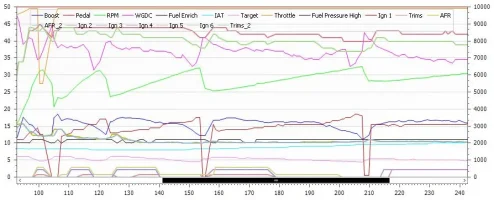

Pump gas 93octane trying out math three just to see how my car handles on it. Or if I should just go back to map 2.
its weird that most peoples max boost is around 15PSI, yet mine hovers 18PSI-21PSI
How cold is it where you are at
Ok so 86 degrees Fahrenheit. That’s really strong do you run map 3 or map 2 what normal octane do use use
map 2, its 98RON (australia) so 93 octane i think for you US people
Some timing corrections. Any reason fuel control is disabled?
I have not had time to hook up the fuel wires let. super busy at work. So just run map 2 and I just bought the EWG wires from you. I heard it will help out big time.
I have not had time to hook up the fuel wires let. Been super busy at work also I just bought the EWG wires from you guys. I heard they will help big time.
I'd get fuel control turned on and then relog map2 and map3.
