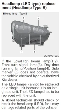

LED High Beam out already :(

I mean, OP's issue fixed itself, so the bulb is still fine. Means we still haven't seen a single one fail in ~2 years of the car being out (Outside of the auto leveling stuff going wonky). Considering the LED bulbs in most OEM stock LED headlights are rated for 100,000 hours, it's actually a cost savings, since the car should be long dead before the bulbs ever need replaced. That's 11.4 years of 24/7 operation, or 3.5 million miles if averaging 35mph on the car. If you live on a planet where it's not dark 24/7, they'll last even longer! I'm cool with that, seeing as how convoluted replacing bulbs in Halogen lit cars is starting to get anyways.

I'm pretty sure that every car offered with LED headlights from the factory works like this. LED's are integrated into the assembly, and the whole assembly needs replaced if/when it dies. That being said, if an LED doesn't fail prematurely, they're rated for ~100,000 hours of on-time. Chances are, the rest of the car will fail long before that, as that's roughly 3.5 million miles if you're averaging 35 MPH over the life of the car, and 11.4 solid YEARS of leaving the headlights on 24/7.
If true than I'm not sure if I feel better or worse, because I'm sure eventually all cars have LED headlights. Obviously one of the great benefits of LED is the longevity, and in a perfect world they would last that long. But things are rarely ever perfect so it would have been nice if they'd come up with a better solution to this. Ultimately it doesn't matter if you have the warranty, but it's going to be a hard sell to own one of these out of warranty with repair bills like that for what should be a cheap part.

I guess it depends on where it fits on the reliability scale, right? Thankfully, it's a binary powered circuit with no moving parts. There aren't many of those in a car, but the stuff that is usually lasts a long time. At that point, it doesn't need to even meet it's full service life. Even if it failed at 30-40k hours instead of 100k, it'll still outlast the car.

Just got back from a 7 day cruise, the right headlight unit has condensation inside the cover and the high beam light is out. Called the dealer for an appointment, will be taking it in on Wednesday. It's a 2018 GT1, 15 months old. So this might be the second high beam failure.

Got a call yesterday that my headlight unit was in. Took it in today and it was replaced and is like new again. Happy with the service, only took six days to order and receive the replacement unit. Took 2 hours to replace, they had to remove the front bumper to install.
