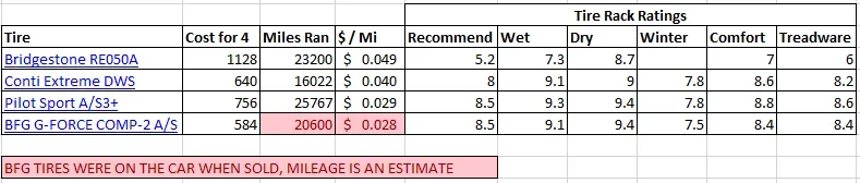

Here is what I got out of my 2010 Subaru Legacy GT. Similar weight / AWD / 25% less power as the Stinger.
